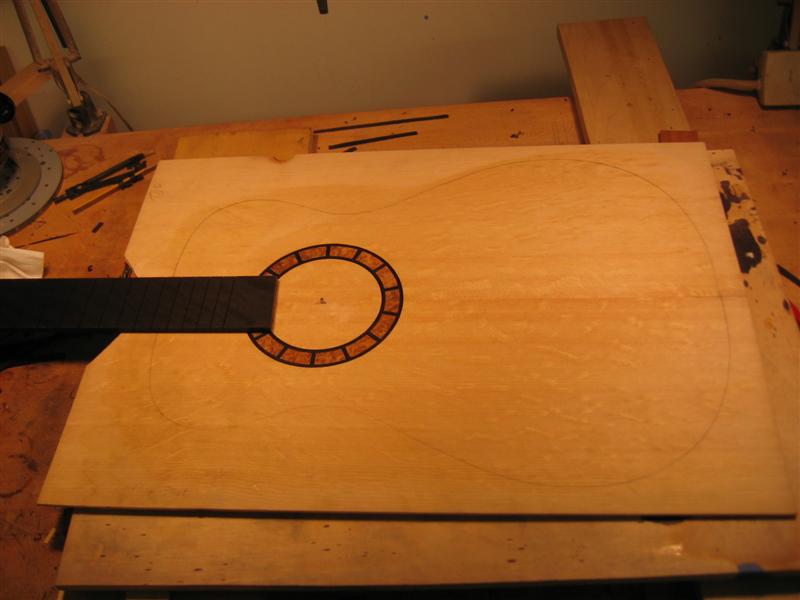

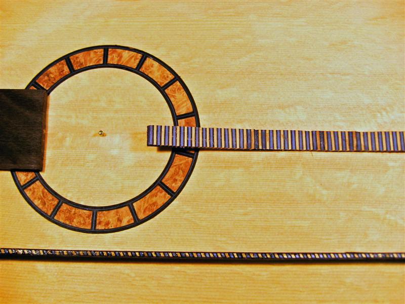

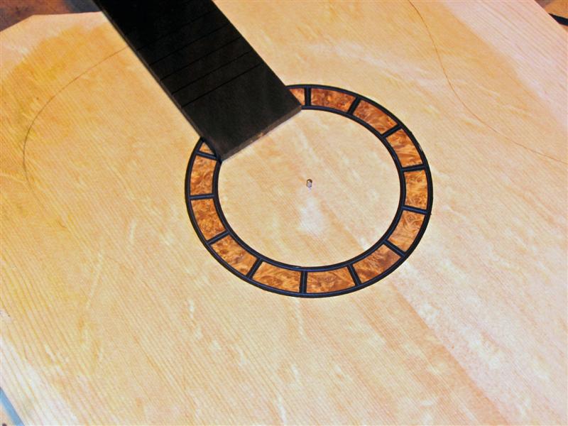

My first attempt at a segmented wooden rosette and rope purfling. The rosette is maple burl. The purfling is maple as well and is my first attempt at dying wood. After soaking it in alcohol dye for a number of days I still wasn't getting even penetration throughout the 1/16 thick slices. I ended up putting them in a bottle and using a hand vacuum pump that was made to preserve opened wine. I was afraid to use my electric vacuum with an alcohol dye. One mistake I did make was when I glued all the segments together into the final strip. I let the strip sit unclamped with only one side with the black veneer. The next morning I had a 36 inch long "U" instead of a flat strip. Luckily I had enough stock to make another.
Thanks for looking, and thanks for all the inspiration.
Bob K

One thing I like about your rosette is the way you use the black/blue/black lines between each segment, but have the lines flow into the outer black/blue/black purfling lines. Although I can think of ways to do that, they would all involve building the entire rosette at once and inlaying it all together. Did you inlay the entire rosette at once?

Wow.    Thanks for all the positive feedback. At this rate I'm not gonna be able to fit my head through the doorway.       Truth be told, I kinda cribbed the rosette idea from Michael Payne's curly narra masterpiece. (minus all the pearl, the super tight miters and all the other intricate details, of course.)
Coe, I had just started cutting the pieces for the rope when you posted pics of your finished guitar. After you said it was a pain I was expecting the worst, so actually doing it didn't seem that bad. Just time consuming. One thing I learned was that next time I need to leave enough raw material to perfectly square up the blank. That makes it much easier to piece the long strip together.
Wade, After seeing the link about wood pickguards I thought about making one from the burl, but that might be a little over the top for me. Tuner knobs? I've never tried that. Any other possibilities??
Mike, I've had the top for a while, it came from Alaska TW. First time I've worked with bear claw. I don't know if there's supposed to be a difference, but it seems tougher than regular sitka.
"Thanks" again to everyone for the compliments. It's great motivation to spend some time working on a bridge
Bob K
PostPosted: Fri Sep 01, 2006 9:27 am
Posts: 449
Kelby, it took me a while to figure that out too. There are probably easier ways, but here's how I did it. I cut the ring blank, routed the top to accept the ring and dry fit the blank. Now the tricky part, for me anyway. Then I got out my pencil, ruler, compass, angle gauge and anything else I could think of to help me figure out the actual segment layout. In the end I eyeballed it, took the ring out of the top and numbered and cut all the segments at the point where the blue line separates them. I then used a sandpaper block to make sure that all the segments were identical. Then I trimmed the width of my black divider line off of the end of each segment, otherwise the segment angles won't line up. Dry fit everything including the black and blue dividers. Once happy with the fit I took everything out and sprayed the top with shellac as I used CA glue in part of the process. Then I white glued in the segment that fits at 6:00. Here's where someone else might have a better solution. Put in the black and blue lines as spacers only - no glue, then glue in the next segment. Continue around the rosette making sure that the segments are as tight as possible. Take out the spacers and let the glue dry. Then get out the router and make the grooves for the black and blue rings. I made the grooves the total width of all of my rings. It makes the next step harder, but the later steps are easier. CA glue in the two black rings that touch the rosette segments. Chisel out the part of the rings that don't frame the segments. Insert the the black and blue dividers making sure they extend to at least the outside edge of the black ring. You may have to cut new ones depending on where you placed your rings. Glue them in and route off the overlap. Install the blue and last black rings and follow that with a CA bath. Hope that helps and sorry for the wordy reply.
